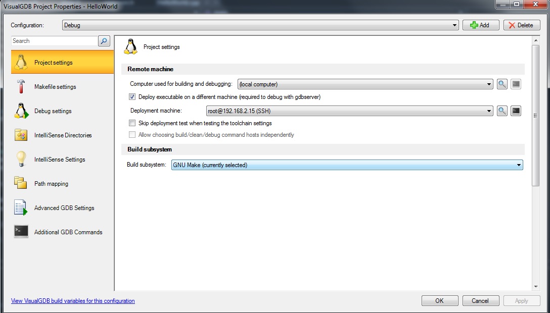

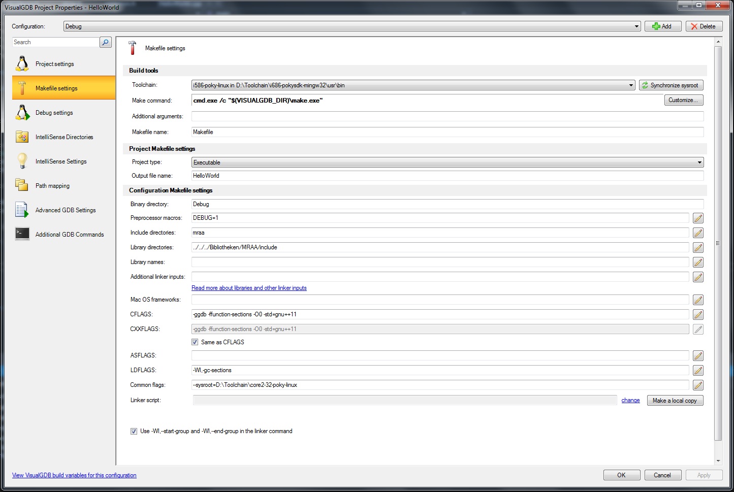

    Here are my settings on VisualGDB:
    ProjectSettings
    MakefileSettings
    The ../../../Bibliotheken/MRAA is the directory identical to the github page from https://github.com/intel-iot-devkit/mraa and contains nothing but *.h files.

    Hi,
    Normally it should be as easy as adding “mraa” to the “Library names” field.
    If you get a “cannot find -lmraa” error, please try the following command line on your Edison:
    gcc -o HelloDemo Test.c -lmraa -Wl,-verbose
    Then check the verbose link log for the actual path of libmraa.a. Once you locate it, simply copy it in the corresponding directory inside your toolchain’s sysroot and VisualGDB should be able to link your program with it.

    thanks for the answer. I tried the command on the Edison itself. This is a part of the gcc output
    attempt to open /usr/lib/gcc/i586-poky-linux/4.9.1/libmraa.so failed
    attempt to open /usr/lib/gcc/i586-poky-linux/4.9.1/libmraa.a failed
    attempt to open /usr/lib/gcc/i586-poky-linux/4.9.1/../../../i586-poky-linux/4.9.1/libmraa.so failed
    attempt to open /usr/lib/gcc/i586-poky-linux/4.9.1/../../../i586-poky-linux/4.9.1/libmraa.a failed
    attempt to open /usr/lib/gcc/i586-poky-linux/4.9.1/../../../libmraa.so succeeded
    I ran another command to make sure the libmraa.a is installed
    /usr/lib$ ls | grep mraa
    libmraa.so
    libmraa.so.0
    libmraa.so.1
    libmraa.so.1.6.1
    libmraajava.so
    It seems like I don’t have the libmraa.a installed. Is there an easy way to do so? Everything that I tried was just for dynamic linking.
    Greetings,
    Thomas
    #11174
    ThomasM
    Participant
    Nevermind. It seems like the build is happy with the libmraa.so as well 😉

    Hi,
    No problem. The shared library should do as well, as long as it is always present on your target system.
