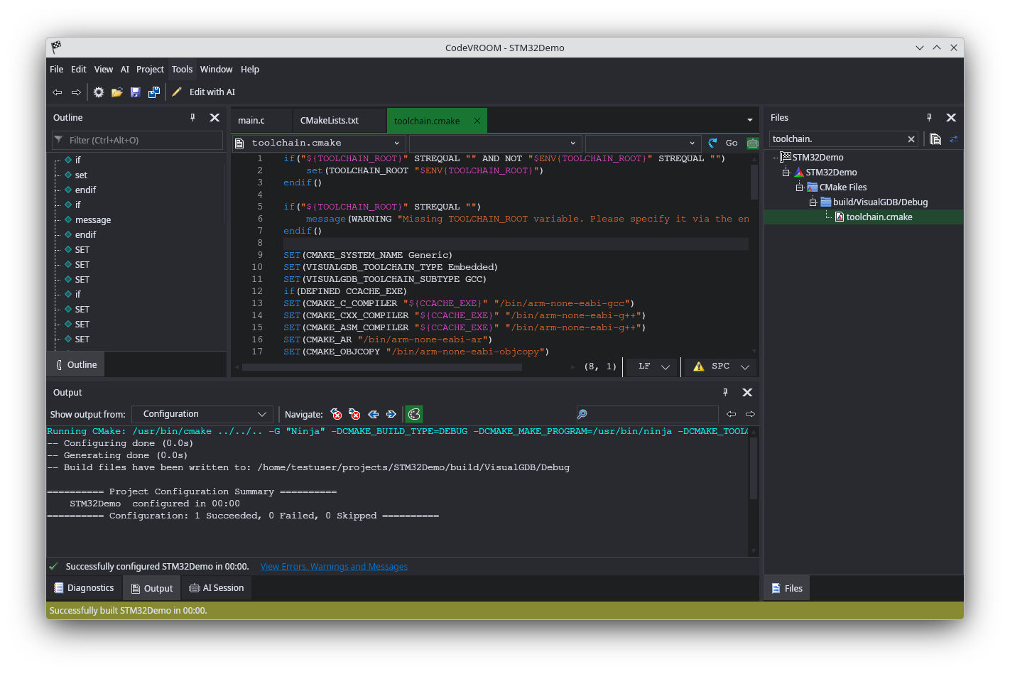

    The mixed ${TOOLCHAIN_ROOT} vs $ENV{TOOLCHAIN_ROOT} are mostly due to historical reasons. Our BSP engine started out with just GNU Make, then got ported to then-limited CMake, and eventually evolved into the current Advanced CMake Project Subsystem. At each step we tried to maintain maximum compatibility with the previous versions, that led to some redundancies.
    That said, we’ve been working a while on a streamlined cross-platform subset of our CMake subsystem (and the Clang-based code navigation), and we just got released the first version. It now expects TOOLCHAIN_ROOT to come from the environment, and sets the regular ${TOOLCHAIN_ROOT} in the generated toolchain.cmake file (see the screenshot). It also now runs natively on Windows, Linux and Mac, including the code navigation. The same update is coming to VisualGDB 6.2.
    ${VISUALGDB_BUILD_SYSTEM_ROOT} now also comes from ${ENV}.
