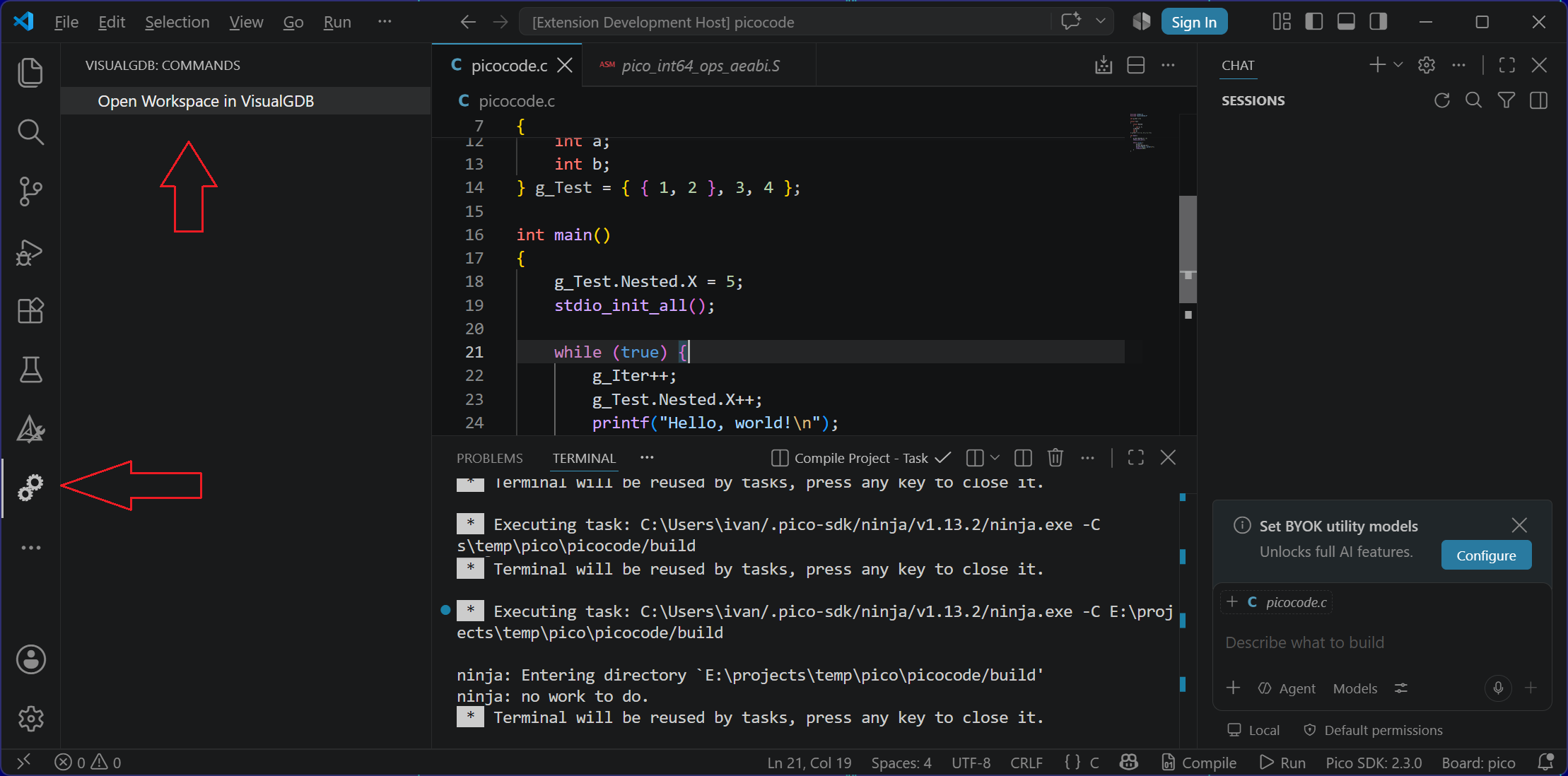

    VisualGDB and the Pico VS Code extension use slightly different project formats. E.g. the VS Code extension hardcodes the SDK version in CMakeLists.txt, while VisualGDB stores it in its own properties file.
    You might be able to get it working by creating 2 projects side-by-side, and merging them one step at a time, but it could require some non-trivial troubleshooting and is generally not recommended.

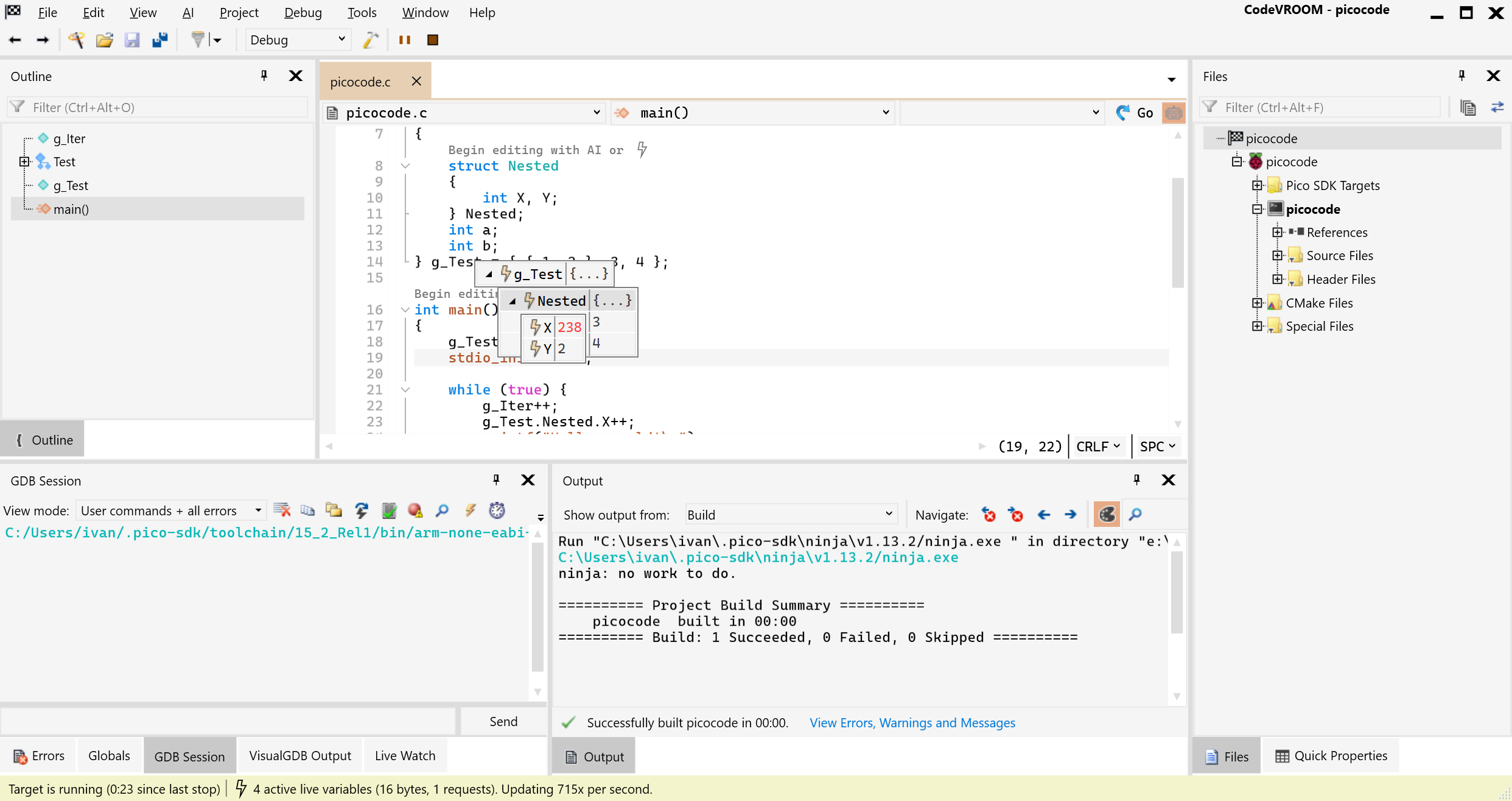

    If you want full interoperability with VS Code, you may want to try VisualGDB for VS Code (visualgdb-vscode-0.0.1.vsix). It transparently translates the VS Code variables to CodeVROOM, so you can just click Open Workspace in VisualGDB inside VS Code, and immediately get the VisualGDB GUI for your project.
