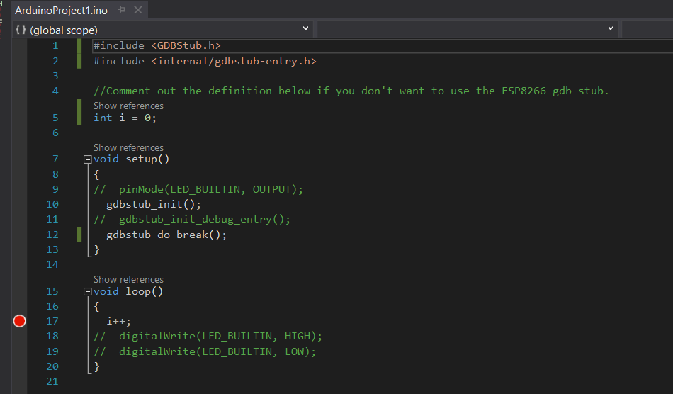

#include <internal/gdbstub-entry.h>The setup() method looks like this, now:
void setup()
pinMode(LED_BUILTIN, OUTPUT);
gdbstub_init();
gdbstub_do_break();
}The gdbstub_do_break() does the trick. Without this line VisualGDB cannot connect to gdbstub. If I remove this line it looks like GDB is not active. After I have added this line and reset the ESP, the GDB string $T05#b9 appears after resetting the ESP.

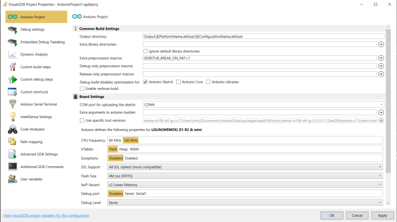

The preprocessor macro GDBSTUB_BREAK_ON_INIT=1 is set, so I don’t know why gdbstub_init() does not wait for a connection, only gdbstub_do_break() does this.

ParticipantI just tested VisualGDB Build 3274. It still shows the same behaviour. Without gdbstub_do_break() after gdbstub_init() VisualGDB can’t connect because GDB is not waiting for a connection.
This is the Arduino settings dialog:
This is the completely stripped down working code:
If I comment out gdbstub_do_break() GDB does not wait for a connection.
Please let me know if you need more information to track down the problem.Regards,
